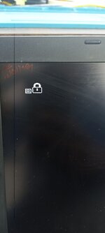

Unlock Bios Password lenovo thinkpad l480 nm-b461
program EC ITE to remove password
  • nm-b461 ITE.bin

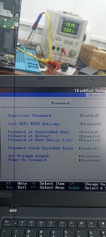

thank you so much but after pressing 1234 the laptop shutdown send another PACHET bios

After installing this bios, press f1 to enter setup password press 1234, after 5 seconds then laptop is powering off, password is not unlocked.

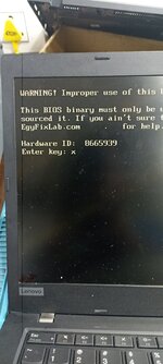

you need instruction just when you write the patched bios after that when your laptop is unlocked you need to flash your bios again with your original dump dont worry the password doesnt exist
user6389
hani
Golden
when you flash your bios an id hardware will apear send for me i will send you unlock code
  • MX25L12 l480_Patched.bin
user6389
hani
Golden
after entre unlock code and every thing is good shutdown laptop and flash the bios with your original bios
